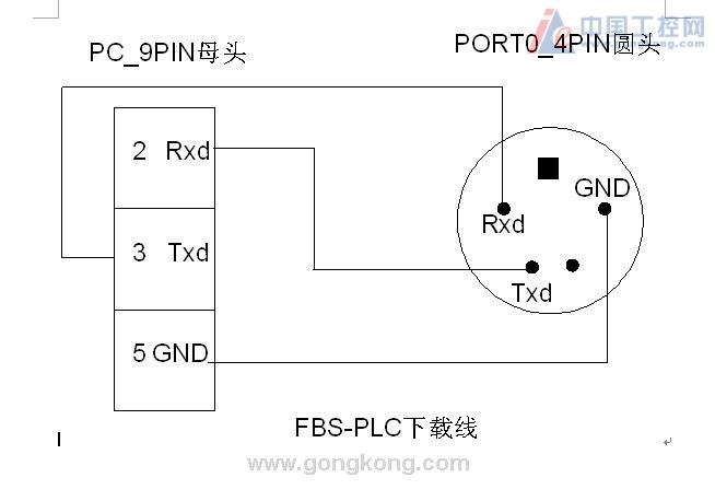

谁有永宏PLC编程缆线,请各位师傅多多指教
