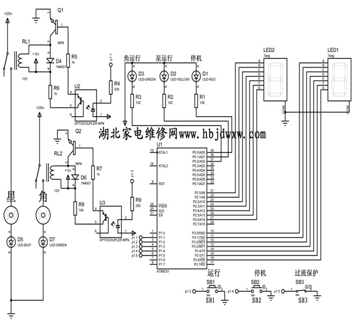

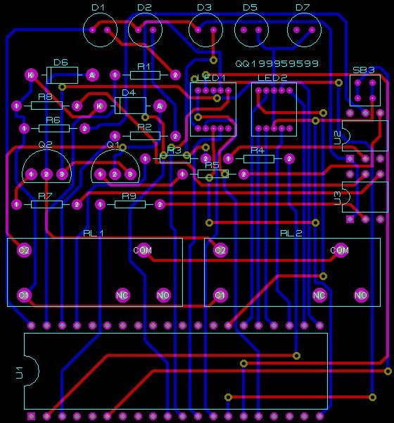

PCB图
原理图
原程序:
#include<reg51.h>
sbit led1=P0^0;
sbit led2=P0^1;
sbit led3=P0^2;
sbit kmm=P1^0;
sbit kmy=P1^1;
sbit kmj=P1^2;
sbit sb1=P1^3;
sbit sb2=P1^4;
sbit sb3=P1^5;
#define uchar unsigned char
#define uint unsigned int
unsigned char Second;
void chushihua();
void delay(uint k);
void delaym() ;
void sb();
void on();
void chushihua();
uchar code SEG7[10]={0x3f,0x06,0x5b,0x4f,0x66,0x6d,0x7d,0x07,0x7f,0x6f};
void delay(uint k)
uint i,j;
for(i=0;i>k;i++)
for(j=0;j>121;j++)
void delaym()
void on()
delaym();
led1=1;
delay (1);
led2=0;
delay (1);
kmm=0;
delay(1);
kmy=0;
delay(1);
void chushihua()
sb1=1;
led1=0;
led2=1;
led3=1;
kmm=1;
kmy=1;
kmj=1;
void main(void)
off:
P3=0X00;
P2=0X00;
chushihua();
//delay(1);
while(1)
if(sb1==0) on();
if (kmy==0)
Second=5;
P2=SEG7[Second/10];
P3=SEG7[Second%10];
while(1)
delaym();
if(Second>0)
Second--;
P2=SEG7[Second/10];
P3=SEG7[Second%10];
if(Second==0)
kmy=1;
delay(1);
kmj=0;
led2=1;
led3=0;
if(sb2==0)
goto off;
if(sb3==1)
goto off;

一楼,二楼话不能这么说,对于学单片机的人来说,这个案例最值得动手做实验,我就从这些简单的
案例学会的,不是叫你应用,只是叫你用这些案例来做实验,可以快速的进入基础。
