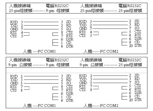

hitech 触摸屏与电脑编程线图纸
