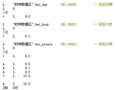

尤其是以下几条,实在是看不明白
= L 9.0
= L 9.1
= L 9.2
A L 9.0
A L 9.1
A L 9.2
= L 10.0
A L 10.0

就把L当成M来看

300的程序~~l对累加器的操作

L是临时变量吧.
