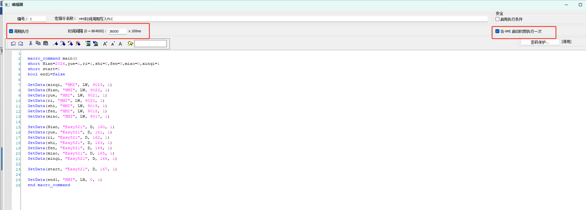

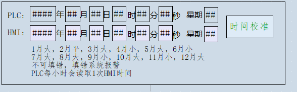

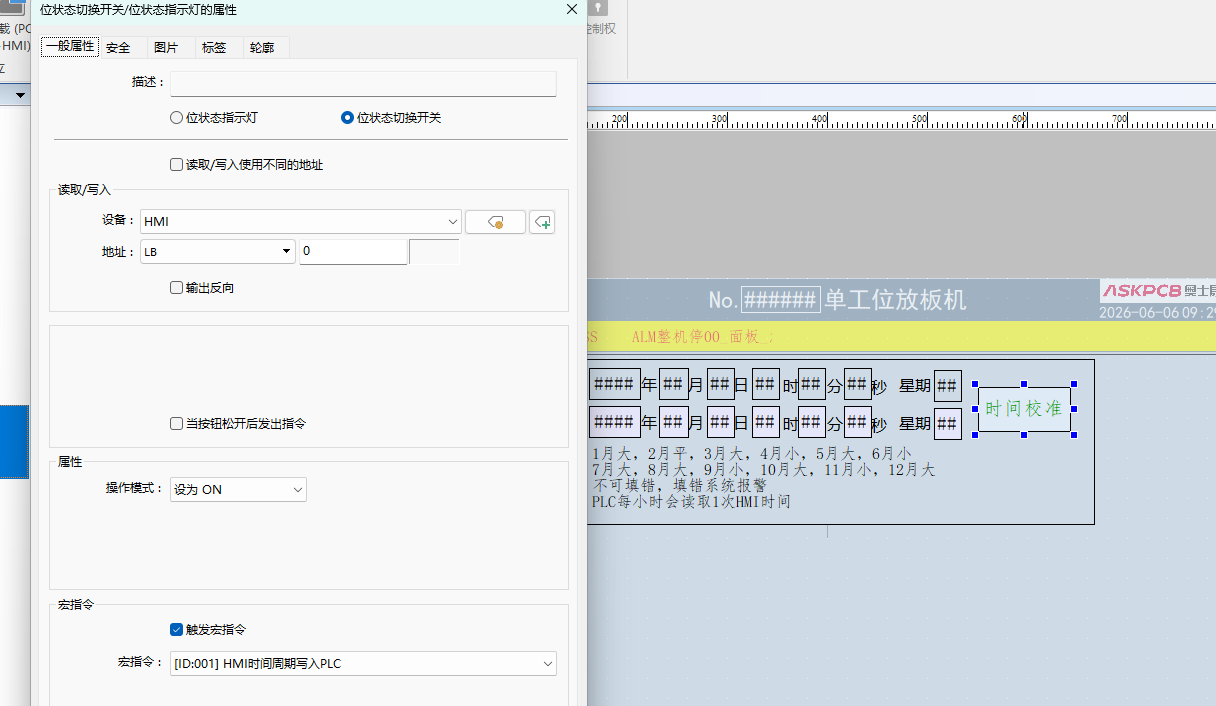

    HMI上的宏指令激活
    有鱼丶
    勿以恶小而为之,勿以善小而不为
    发帖数量: 279 个
    工控威望: 361 点
    下载积分: 324 分
    在线时间: 142(小时)
    注册时间: 2024-07-13
    最后登录: 2026-06-06
    查看有鱼丶的 主题 / 回贴
    2楼  发表于: 13小时前
    macro_command main()
    short Nian=2026,yue=1,ri=1,shi=0,fen=0,miao=0,xinqi=1
    short start=1
    bool end1=false

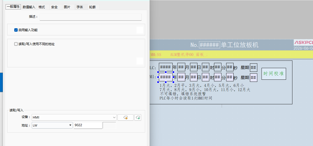

    GetData(xinqi, "HMI", LW, 9023, 1)
    GetData(Nian, "HMI", LW, 9022, 1)
    GetData(yue, "HMI", LW, 9021, 1)
    GetData(ri, "HMI", LW, 9020, 1)
    GetData(shi, "HMI", LW, 9019, 1)
    GetData(fen, "HMI", LW, 9018, 1)
    GetData(miao, "HMI", LW, 9017, 1)

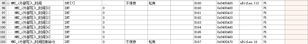

    SetData(Nian, "Easy521", D, 160, 1)
    SetData(yue, "Easy521", D, 161, 1)
    SetData(ri, "Easy521", D, 162, 1)
    SetData(shi, "Easy521", D, 163, 1)
    SetData(fen, "Easy521", D, 164, 1)
    SetData(miao, "Easy521", D, 165, 1)
    SetData(xinqi, "Easy521", D, 166, 1)
    SetData(start, "Easy521", D, 167, 1)
    SetData(end1, "HMI", LB, 0, 1)
    end macro_command
