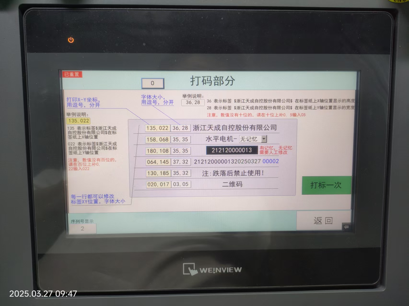

//驱动打印机报文 ---------------------------------------------------------
//^XA
//^LRN
//^CW1,E:SIMSUN.TTF^FS
//^CI28
//^FO135,22^A1N,36,28,^FD浙江天成自控股份有限公司^FS
//^FO158,68^A1N,35,35,^FD水平电机-无记忆^FS
//^FO180,106^A1N,35,35,^FD212120000014^FS
//^FO64,145^A1N,37,32,^FD2121200000142025031500730^FS
//^FO120,185^A1N,35,32,^FD注:跌落后禁止使用!^FS
//^FO20,17^BQN,3,5
//^FDLA.2121200000142025031500730^FS
//^PQ1,0,1,Y^XZ
// 构建ZPL指令------------------------------------------------------------
附件: 威纶控制斑马打印机.rar (4487 K) 下载次数:293

    触摸屏做打印机,客户的需求多变就很难满足哦

    多变就做成多模版,每个模板多少钱,看钱多了就不变了

    CRLF 用LF  代替行吗,,也就是0D0A  只用0A
