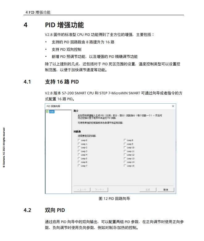

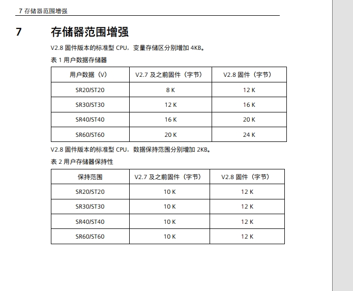

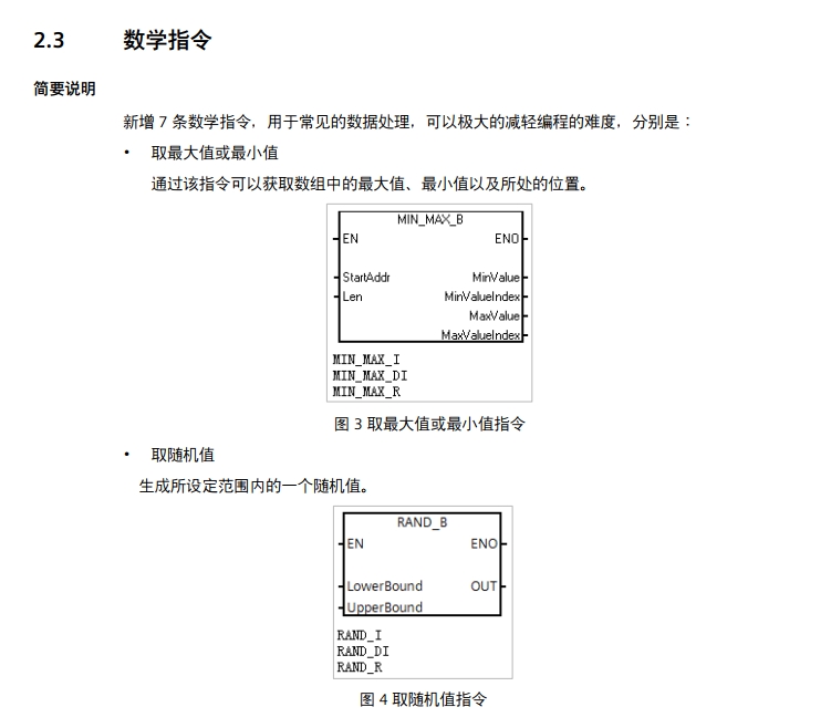

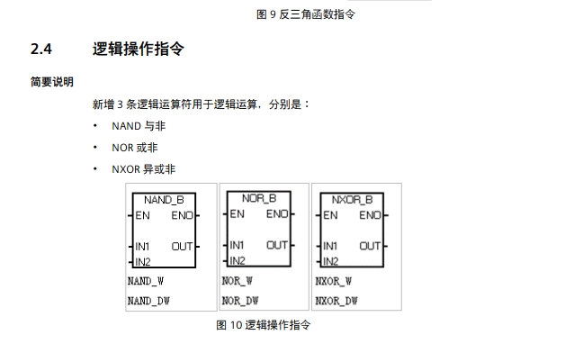

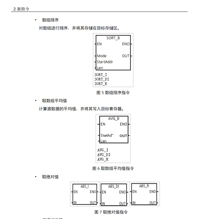

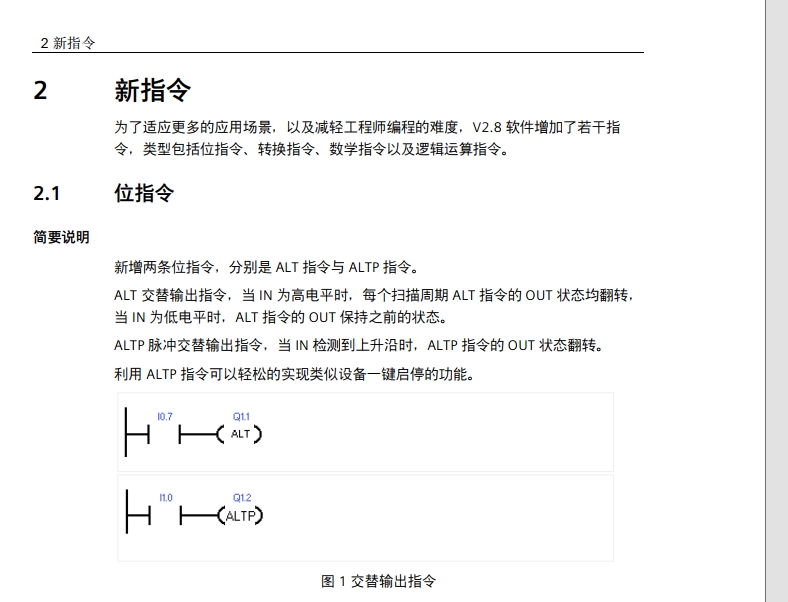

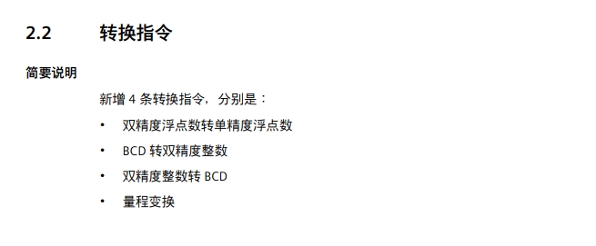

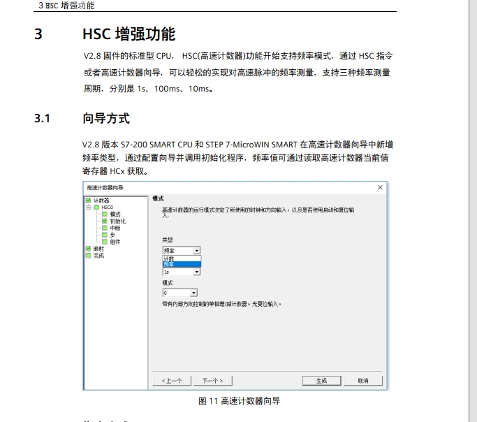

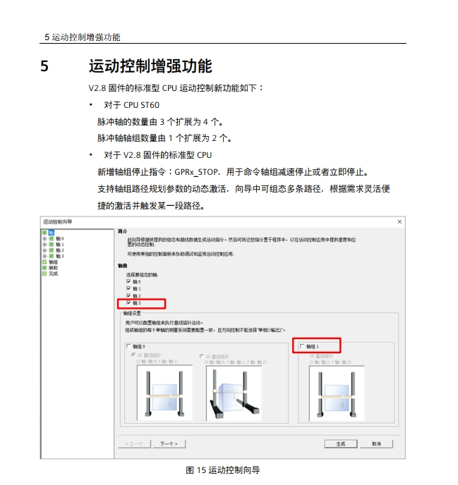

西门子STEP7-MicroWIN-SMART-V2.8更新部分

200smart V2.8下载链接 - 工控人家园
https://assets.new.siemens.com/siemens/assets/api/uuid:62588c50-1d85-4fd0-8ff5-507431ebdd3b/STEP7-MicroWIN-SMART-V2.8.zip
http://www.ymmfa.com/read-gktid-1760095.html
[ 此帖被梦雨天涯在2024-01-26 14:53重新编辑 ]
STEP7-MicroWIN-SMART-V2.8.zip新增功能.pdf
(759 K) 下载次数:130
