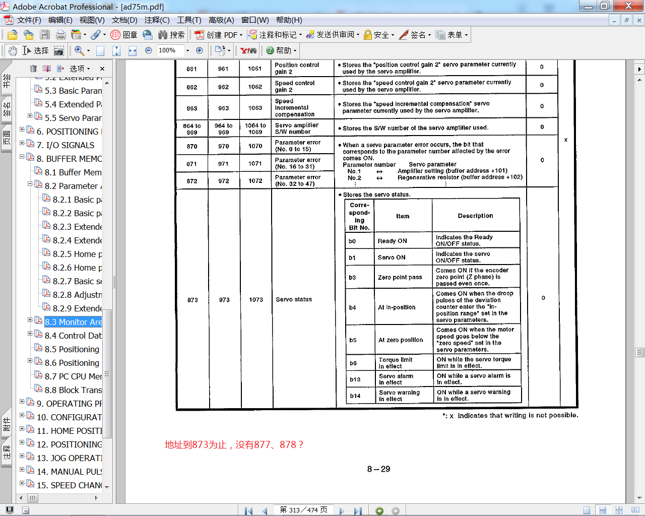

A1SD75M2说明书内没有的地址,在程序中是表示什么?手册内容+程序如下:

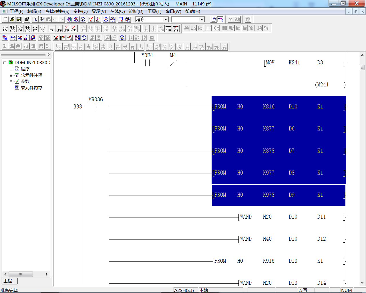

估计没用的废步,看看程序D6 D7 D8 有用没?

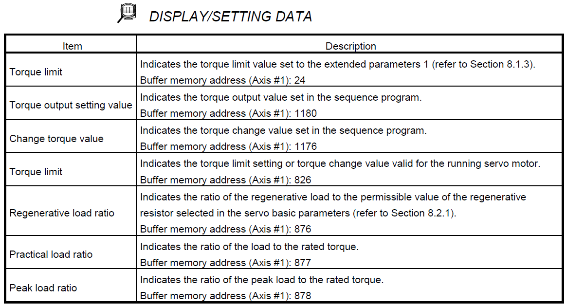

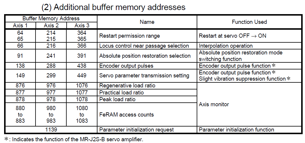

Practical load ratio
Indicates the ratio of the load to the rated torque.
Buffer memory address (Axis #1): 877
Peak load ratio
Indicates the ratio of the peak load to the rated torque.
Buffer memory address (Axis #1): 878
