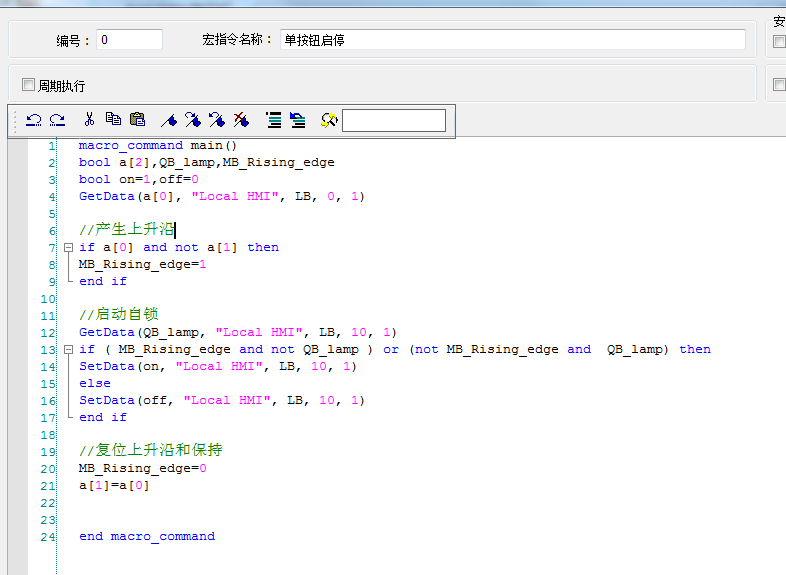

第一次
macro_command main()
bool a[2],QB_lamp,MB_Rising_edge
bool on=1,off=0
GetData(a[0], "Local HMI", LB, 0, 1)
//产生上升沿
if a[0] and not a[1] then
MB_Rising_edge=1
end if
//启动自锁
GetData(QB_lamp, "Local HMI", LB, 10, 1)
if ( MB_Rising_edge and not QB_lamp ) or (not MB_Rising_edge and  QB_lamp) then
SetData(on, "Local HMI", LB, 10, 1)
else
SetData(off, "Local HMI", LB, 10, 1)
end if
//复位上升沿和保持
MB_Rising_edge=0
a[1]=a[0]
end macro_command

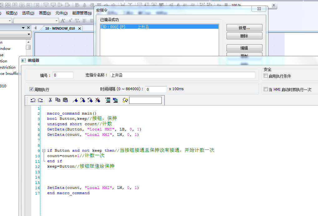

    看到以上程序,就感觉有点复杂了,于是先写一个上升沿的程序
    bool Button,keep//按钮,保持
    unsigned short count//计数
    GetData(Button, "Local HMI", LB, 0, 1)
    GetData(count, "Local HMI", LW, 0, 1)
    if Button and not keep then//当按钮接通且保持没有接通,开始计数一次
    count=count+1//计数一次
    end if
    keep=Button//按钮赋值给保持
    SetData(count, "Local HMI", LW, 0, 1)
    end macro_command

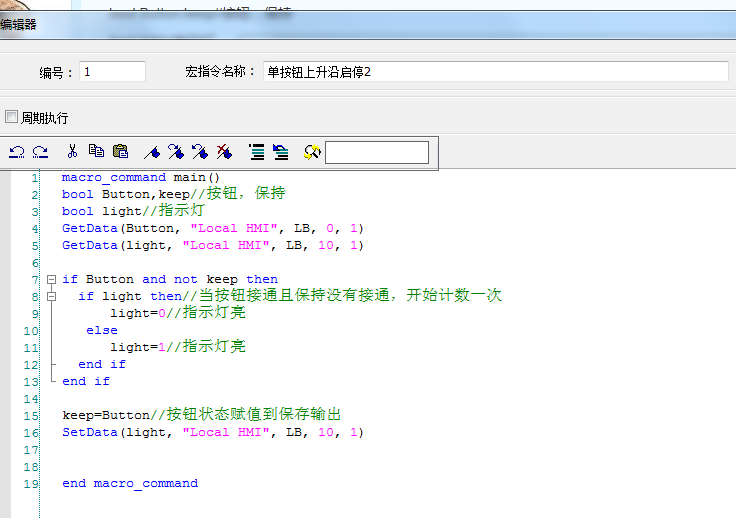

    第三次,有了以上思路,然后继续写
    bool light//指示灯
    GetData(light, "Local HMI", LB, 10, 1)
      if light then//当按钮接通且保持没有接通,开始计数一次
          light=0//指示灯亮
       else
          light=1//指示灯亮
      end if
    end if
    keep=Button//按钮状态赋值到保存输出
    SetData(light, "Local HMI", LB, 10, 1)
    end macro_command

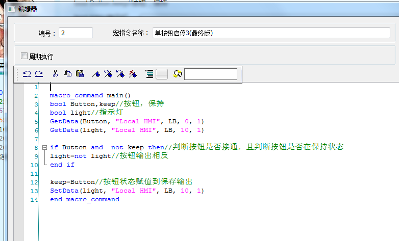

    发现第二个IF是可以简化的,再次简化可得
    bool light//指示灯
    if Button and  not keep then//判断按钮是否接通,且判断按钮是否在保持状态
    light=not light//按钮输出相反
    end if
    end macro_command

    不断简化,精益求精,程序逻辑和思路整理的过程,这就是学习
