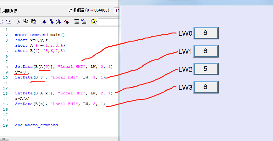

威纶通漏洞所在??
macro_command main()
short x=0,y,z
short A[4]={1,2,3,4}
short B[4]={5,6,7,8}
SetData(B[A[0]], "Local HMI", LW, 0, 1)
y=A[0]
SetData(B[y], "Local HMI", LW, 1, 1)
SetData(B[A[x]], "Local HMI", LW, 2, 1)
z=A[x]
SetData(B[z], "Local HMI", LW, 3, 1)
end macro_command

难道是因为,B[A[x]]需要嵌套运算三次,比其他的多运算一次,所以A[X]没有计算直接按0参与B的计算了?
