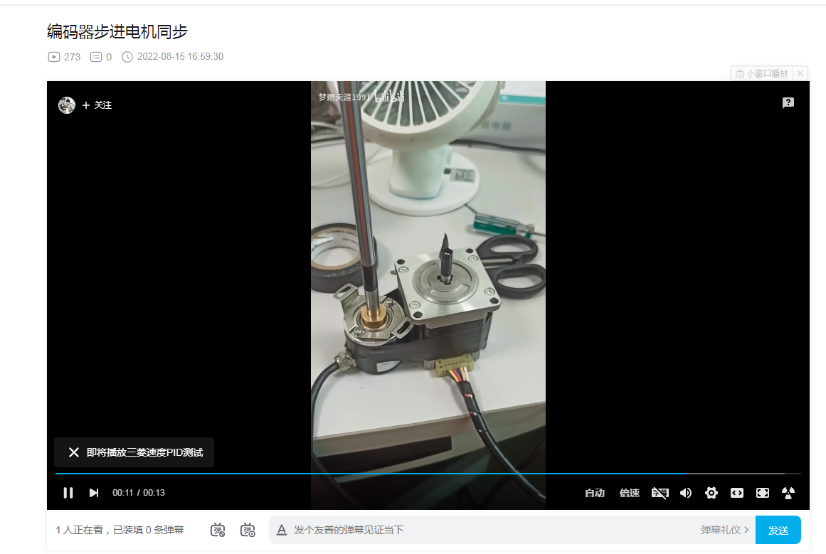

https://www.bilibili.com/video/BV1yt4y1g7uE/?vd_source=bd98370170cd04f9ea404d49b3e1ce5b
大概这样吧……
