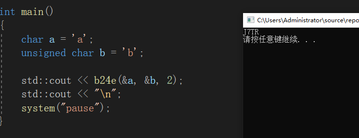

这个函数原理和调用????C的高手看看!!!
static const char sel[] = {
'B','C','D','F','G',
'H','J','K','M','P',
'Q','R','T','V','W',
'X','Y','2','3','4',
'6','7','8','9', '\0'};
char *b24e(char *buf, unsigned char *byst, size_t sizeOfBytes)
int i = 0;
unsigned char *p = byst;
while ((size_t)(i = (p-byst)) < sizeOfBytes) {
  buf[2*i] = sel[((*p) >> 4)];
  buf[(2*i)+1] = sel[23 - ((*p) & 0x0f)];
  p++;
buf[(2*i)+1] = '\0';
return buf;
unsigned char *b24d(unsigned char *buf, char *str, size_t countOfChars)
size_t i;
char *p = str;
char *loc[2];
unsigned char n[2];
if (countOfChars % 2)
  return NULL;
for (i = 0; i < (countOfChars>>1); i++) {
  loc[0] = strchr( sel, str[2*i] );
  loc[1] = strchr( sel, str[ ( 2*i ) + 1 ] );
  if (loc[0] == NULL || loc[1] == NULL)
   return NULL;
  n[0] = (unsigned char)( loc[0] - sel );
  n[1] = 23 - (unsigned char)( loc[1] - sel );
  buf = (unsigned char)((n[0] << 4) | n[1]);
return buf;

好像就是类似动态密码的东西,把你输入的东西,按照这个转换成一个码,码由你最上面定义的那个字符数组组成。
