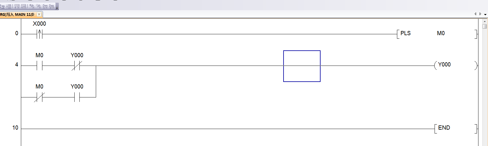

macro_command main()
bool a[2],QB_lamp,MB_Rising_edge
bool on=1,off=0
GetData(a[0], "Local HMI", LB, 0, 1)
//产生上升沿
if a[0] and not a[1] then
MB_Rising_edge=1
end if
//启动自锁
GetData(QB_lamp, "Local HMI", LB, 10, 1)
if ( MB_Rising_edge and not QB_lamp ) or (not MB_Rising_edge and  QB_lamp) then
SetData(on, "Local HMI", LB, 10, 1)
else
SetData(off, "Local HMI", LB, 10, 1)
end if
//复位上升沿和保持
MB_Rising_edge=0
a[1]=a[0]
end macro_command
程序已经测试过,欢迎来讨论改进

    交替指令呢

    引用第3楼wenqing1012于2022-06-25 17:57发表的  :
    交替指令呢
    宏指令可没有alt啊。。
