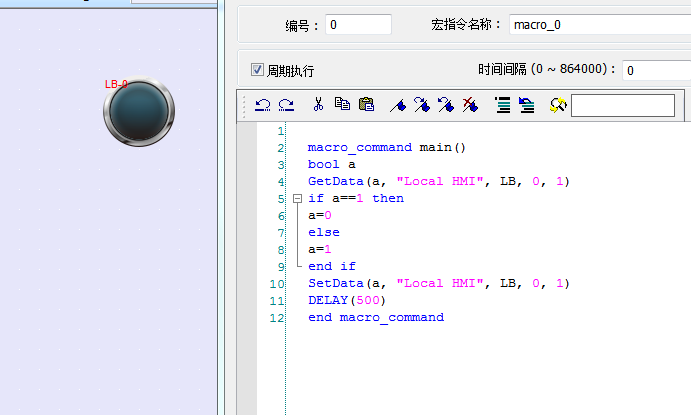

入图所示
macro_command main()
bool a
GetData(a, "Local HMI", LB, 0, 1)
if a==1 then
a=0
else
a=1
end if
SetData(a, "Local HMI", LB, 0, 1)
DELAY(500)
end macro_command

谢谢大佬分享

BOOL类型赋值0或者1,看你入门最多C
