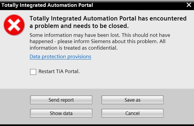

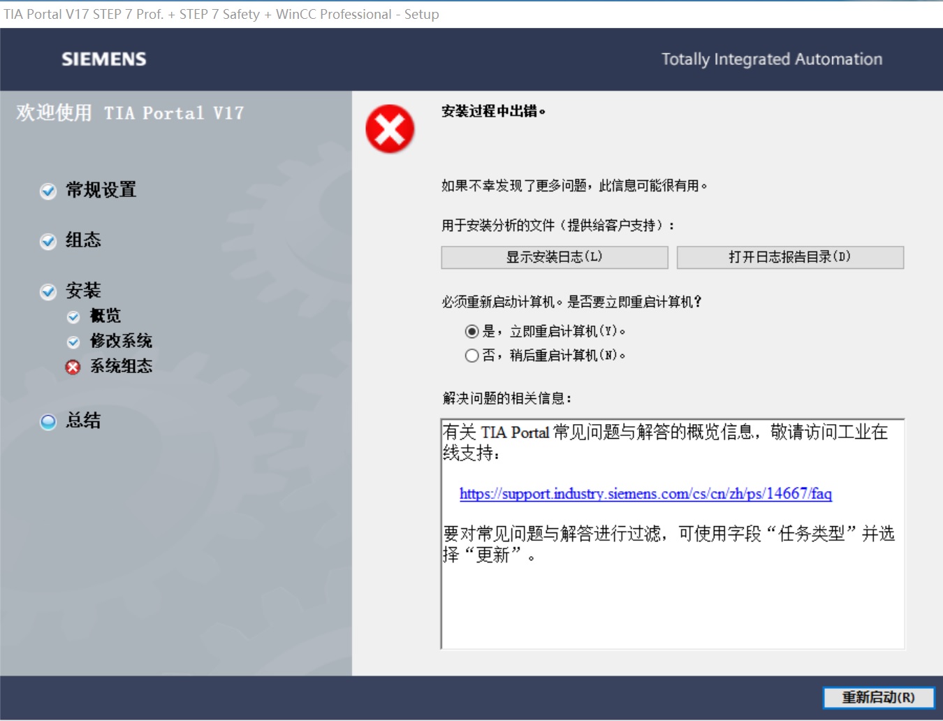

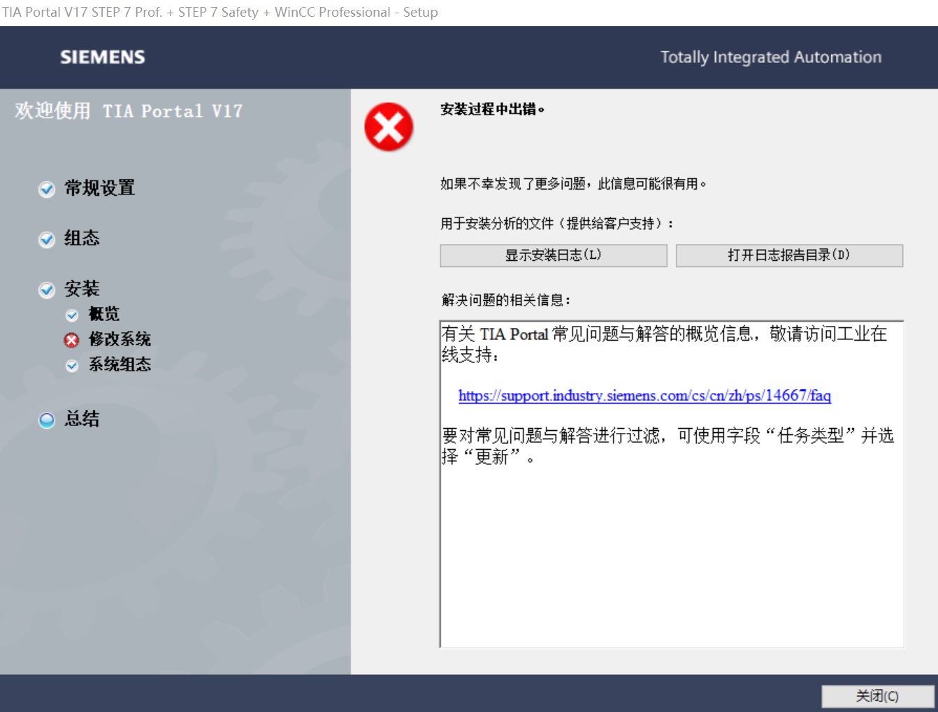

安装博图17是发生图片上的错误,哪位大神知道如何解决,第一次装博图软件。

1楼  发表于: 2022-01-01 11:37
你是不是开了360等安全杀毒软件?

2楼  发表于: 2022-01-01 12:54
难道不应该点击一下显示安装日志么

打开软件就是个红叉叉。

4楼  发表于: 2022-01-02 20:02
19:42:47 | OK                        MspInstall                 ()                          Complete
19:42:47 | OK                        StartApplAfter             (TIAP17::[INSTALLDIR]BIN\INSTALLROOTCERTIFICATE.EXE)Complete
19:42:49 | OK                        StartApplAfter             (TIAADMIN::[INSTALLDIR]SERVER\NODE.EXE)Complete
19:46:30 |ERROR    AdsWorkerForeignExe::GetInstallResult():  - 300: assuming unknown error, because return value <> 0 and either OK- nor ERROR-values are defined. Please check the corresponding log file for more detailed information
19:46:30 | FAIL!                     StartApplAfter             (TIAP17::[INSTALLDIR]BIN\SIEMENS.AUTOMATION.GENERATOR.FRAMEWORK.EXE)Failed
19:46:30 | OK                        StartApplAfter             (TIAADMIN::TIAADMINNOTIFIER.EXE)Complete
19:46:30 | OK                        StartApplAfter             (TIAP17::C:\WINDOWS\SYSWOW64\S7EPATSX.EXE)Complete
19:46:31 | OK                        StartApplAfter             (TIAP17::C:\WINDOWS\SYSWOW64\S7EPAESX.EXE)Complete
19:46:34 | OK                        StartApplAfter             (TIAP17::[INSTALLDIR]BIN\SIEMENS.SIMATIC.HWCN.INTERPRETER.IG.GSD.GENERATOR.EXE)Complete
19:46:42 | OK                        ProductRegistration        (After)                     Complete
19:46:43 | OK                        SetupIsComplete            ()                          Complete
19:46:44 | OK                        InventoryAfter             (Z)                         Complete
19:46:44 | OK                        LicenseTransfer            (False)                     BeforeStart
19:46:44 | OK                        Citamis                    (After)                     Complete
19:46:44 | OK                        SetupSummary               ()                          Complete
19:47:35 | OK                        SetupReport                ()                          Complete
19:47:35 | END. Execution completed.
Intermediate ExitCode after execution queue : 1603 - Exit code means: Installation failed (InstallFailure)

5楼  发表于: 2022-01-02 21:06
之前的木删除干净。要不就是注册表没有删除。
