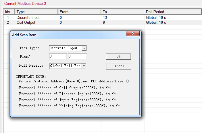

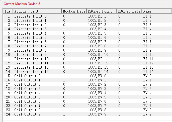

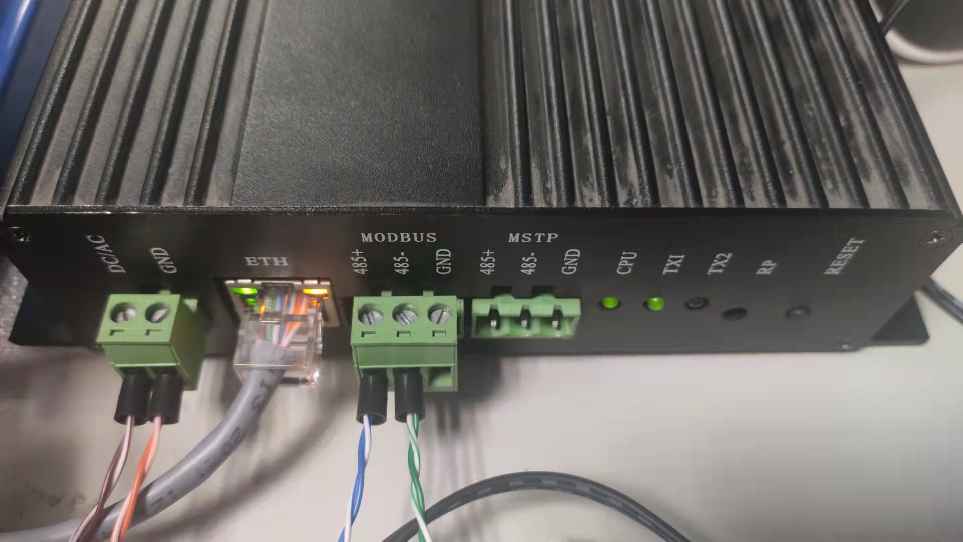

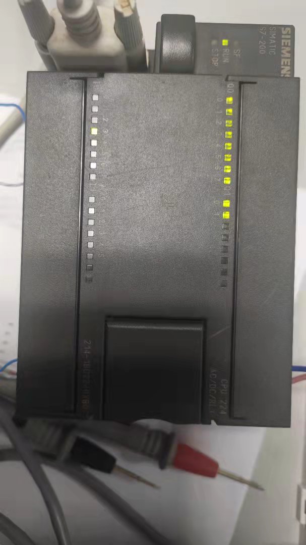

大家好,请教一下西门子S7-200(Slave从站) Modbus转BACnet(广州迪盛网关)线圈写入配置问题,望大神不吝赐教!
PLC:
BACnet网关 :
项目地址:
I0.0~I1.5和Q0.0~Q1.1的状态读取Modbus数据正常,响应及时;
试了各种方法,没有成功在网关配置写入。

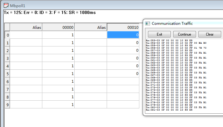

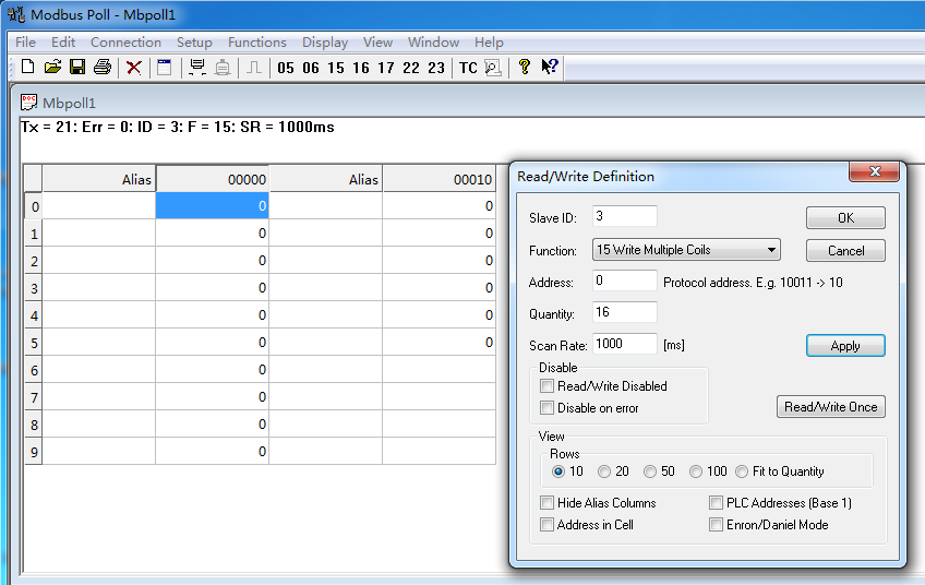

以下是Modbus Poll的写入测试,正常响应:
Q线圈单写入:
Tx:03 05 00 08 FF 00 0C 1A
Rx:03 05 00 08 FF 00 0C 1A
Tx:03 05 00 08 00 00 4D EA
Rx:03 05 00 08 00 00 4D EA
Q线圈多写入:
Tx:036-03 0F 00 00 00 10 02 00 00 FB 40
Rx:037-03 0F 00 00 00 10 55 E5
Tx:038-03 0F 00 00 00 10 02 01 00 FA D0
Rx:039-03 0F 00 00 00 10 55 E5
Tx:042-03 0F 00 00 00 10 02 03 00 FB B0
Rx:043-03 0F 00 00 00 10 55 E5
Tx:044-03 0F 00 00 00 10 02 07 00 F9 70
Rx:045-03 0F 00 00 00 10 55 E5
Tx:046-03 0F 00 00 00 10 02 0F 00 FE B0
Rx:047-03 0F 00 00 00 10 55 E5
Tx:048-03 0F 00 00 00 10 02 1F 00 F3 70
Rx:049-03 0F 00 00 00 10 55 E5
Tx:050-03 0F 00 00 00 10 02 3F 00 EA B0
Rx:051-03 0F 00 00 00 10 55 E5
Tx:052-03 0F 00 00 00 10 02 7F 00 DB 70
Rx:053-03 0F 00 00 00 10 55 E5
Tx:054-03 0F 00 00 00 10 02 FF 00 BA B0
Rx:055-03 0F 00 00 00 10 55 E5
Tx:056-03 0F 00 00 00 10 02 FF 01 7B 70
Rx:057-03 0F 00 00 00 10 55 E5
Tx:058-03 0F 00 00 00 10 02 FF 03 FA B1
Rx:059-03 0F 00 00 00 10 55 E5

最后 ,自己用土办法,把网关的MODBUS RTU信号接到电脑上,通过poll监视,发现网关发出的写入命令是对的,所以问题集中在PLC上,果然,全部重新上电,让网关再和PLC取得充分地通讯,写操作就有效了!
