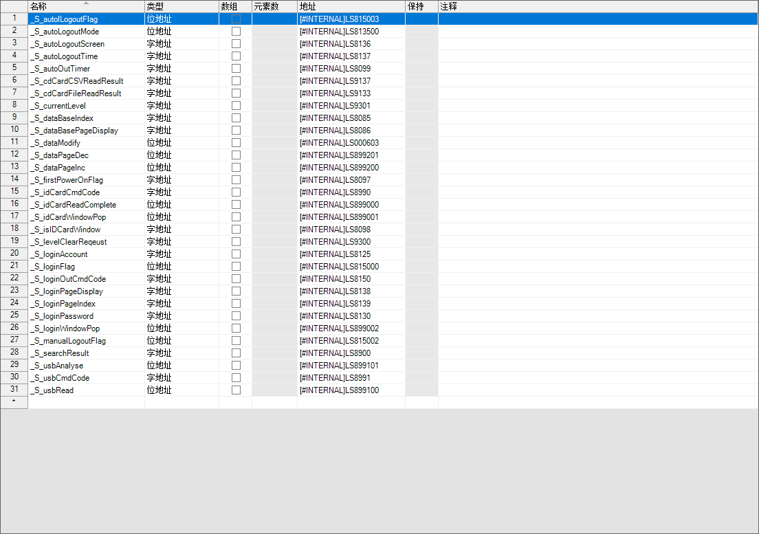

自己写了个小脚本感觉比起威伦来说功能太少了,能不能用数组?可以定义脚本变量吗?定义脚本数组变量吗?

工程窗口最下面可以定义符号变量
if([w:_S_currentLevel]<>0)
    memset([w:#H_SecurityChangeUserID], 0, 2)
    memset([w:#H_SecurityChangePassword], 0, 2)
    [b:#H_Control_SecureChangeTrigger]=0
    [t:0000]=([w:_S_searchResult]-1)*25
    [t:0001]=0
    _memcpy_EX([w:[#INTERNAL]LS8100]#[t:0001], [w:[#INTERNAL]USR18000]#[t:0000], 25)
    if([b:_S_loginFlag])
        [t:0088]=1
        Call LoginLog
        set([b:_S_manualLogoutFlag])
    endif
    [w:[#INTERNAL]LS6000]=[w:[#INTERNAL]LS6000]+1
else
    if([w:_S_levelClearReqeust]<>0)
        [w:_S_levelClearReqeust]=0
    endif
    if([b:_S_manualLogoutFlag])
        [t:0088]=2
        Call LoginLog
    endif
    if([b:_S_autolLogoutFlag])
        [t:0088]=3
        Call LoginLog
    endif
    memset([w:[#INTERNAL]LS8100], 0, 25)
    [w:[#INTERNAL]LS6001]=[w:[#INTERNAL]LS6001]+1
endif
