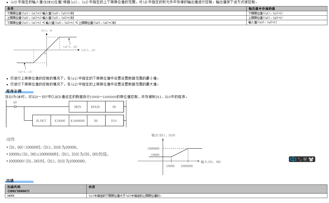

ST指令
LIMITP( ?BOOL_EN? , ?ANY16_S_s1? , ?ANY16_S_s2? , ?ANY16_S_s3? , ?ANY16_S_d? );
LIMITP( M0,-1000,2000,D0,D10);
//D0,输入,D10输出,
