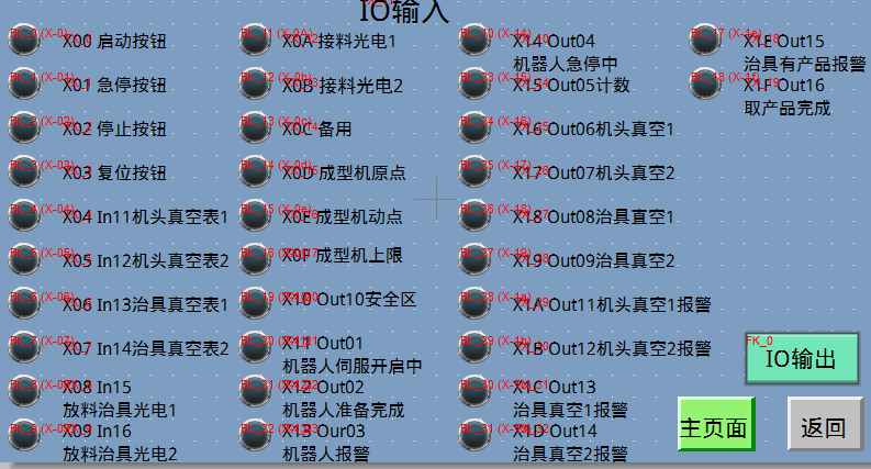

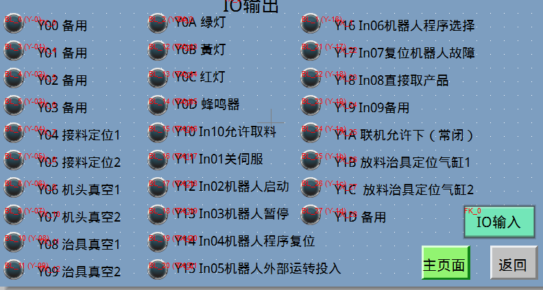

机器人取放产品,定位。以及加工(赶毛边打磨)
想试下码垛,但看说明书不太了解,
ALLCLR
*QUYU
GETP V101!
IF V102!>V170! THEN *A ELSE *B
*A
V103! = V171!
P555 = (V101!,V102!,V103!,V104!,V105!,V106!)
MOVEX A=8,AC=0,SM=0,M1X,L,P555,S= 600.0,H=1,MS
MOVEX A=1,AC=0,SM=0,M1X,L,(276.041,264.139,594.578,3.078,-2.797,-178.853),R= 100,H=1,MS, CONF=0000    'Yguodu
GOTO *C
*B
V103! = V103!+100
*C
MOVEX A=1,AC=0,SM=0,M1X,P,(225.023,0.633,594.503,3.078,-2.795,-178.865),R=50.0,H=1,MS, CONF=0010    'P88原点
SETM O2,1    '机器人准备完成
*DAIJI
IF I10=1 THEN *QULIAO    '
GOTO *DAIJI
END
*QULIAO
SETM O10,1    '不允许下
DELAY 0.2
IF I08=1 THEN *ZHIJIEFAN    '直接放料
MOVEX A=1,AC=0,SM=0,M1X,L,(276.033,264.124,594.534,3.079,-2.797,-178.859),R=90.0,H=1,MS, CONF=0000    'P90过渡
*QUYI

    楼主,最好能分享一下完整的项目资源,毕竟那智的应用也是比较少的
