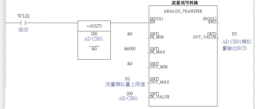

关于流量功能区块Function blocks,
之前的前辈写的程式中有Function blocks
我这块不是很熟

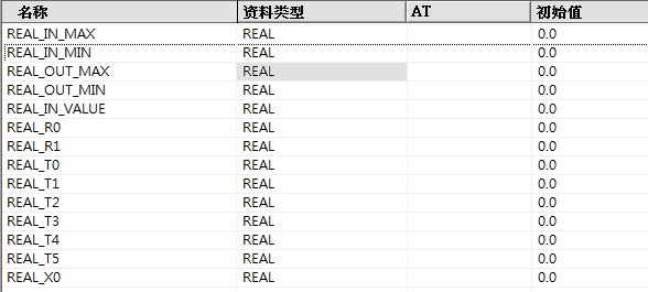

请问有人可协助解释下面程式中,转换程序内容?
IF IN_MAX >= IN_VALUE AND IN_VALUE >= IN_MIN OR IN_MAX <= IN_VALUE AND IN_VALUE <= IN_MIN THEN;
REAL_IN_MAX := INT_TO_REAL (IN_MAX);
REAL_IN_MIN := INT_TO_REAL (IN_MIN);
REAL_OUT_MAX := INT_TO_REAL (OUT_MAX);
REAL_OUT_MIN := INT_TO_REAL (OUT_MIN);
REAL_IN_VALUE := INT_TO_REAL (IN_VALUE);
REAL_T0 := REAL_IN_MAX - REAL_IN_MIN;
REAL_R0 := ABS(REAL_T0);
REAL_T1 := REAL_OUT_MAX - REAL_OUT_MIN;
REAL_R1 := ABS(REAL_T1);
REAL_T2 := REAL_R0 / REAL_R1;
IF REAL_T0 < 0.0 XOR REAL_T1 <0.0 THEN;
REAL_T3 := REAL_IN_MIN - REAL_IN_VALUE;
ELSE;
REAL_T3 := REAL_IN_VALUE - REAL_IN_MIN;
END_IF;
REAL_T4 := REAL_T3 / REAL_T2;
REAL_T5 := REAL_T4 + REAL_OUT_MIN;
REAL_X0 := REAL_T5;
OUT_VALUE := REAL_TO_INT (REAL_X0);

先看第一行,
目前看起来是
当 IN_VALUE (AD CH01 2000) 有值时 他会去比较
如果 IN_MAX (类比输入&6000)流量器具显示最大值 大于等于 IN_VALUE 实际值 (AD CH01 2000) 并且, IN_VALUE 实际值(AD CH01 2000) 大于等于IN_MIN(类比输入&0)
, 或 ,                                     //在来下面看起怪怪的,好像实际值为负值
IN_MAX (类比输入&6000) 小于等于 IN_VALUE 实际值 (AD CH01 2000) 并且
IN_VALUE 实际值 (AD CH01 2000) 小于等于 IN_MIN(类比输入&0) ,
则执行下面动作

所以会有负值可能为预留电压输入-10V~ + 10V  ?
目前是使用电流输入4mA〜20mA
