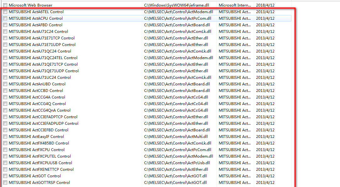

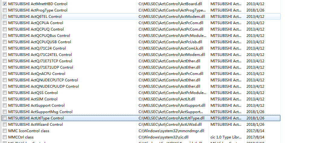

MX Component 使用控件通讯 就可以直接PLC内部地址的名字,不要在整个标签。
标签能了很久 还是不行。
控件有很多
感觉三菱每个可以通讯的硬件 都有一个对应的  控制可以使用

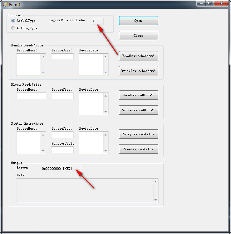

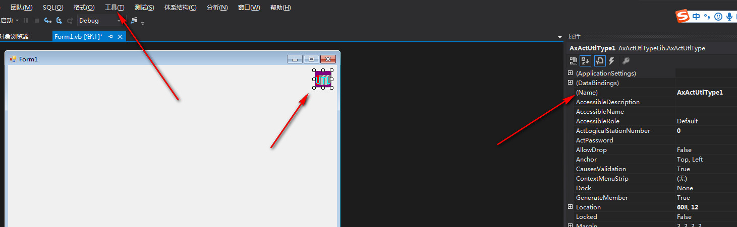

    验证通过AxActUtlTypeLib.AxActUtlType访问Q04UDV的CPU,硬件接口为以太网
    新建一个VB.net  ,窗口程序,在工具栏里面添加 控件
    如下图:

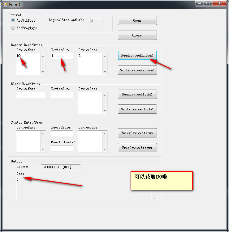

    随机读取
    #Region "随机写入 PLC里面的地址"
        Private Sub btn_ReadDeviceRandom2_Click(sender As Object, e As EventArgs) Handles btn_ReadDeviceRandom2.Click
            Dim iReturnCode As Integer              'Return code
            Dim szDeviceName As String = ""         'List data for 'DeviceName'
            Dim iNumberOfDeviceName As Integer = 0  'Data for 'DeviceSize'
            Dim sharrDeviceValue() As Short         'Data for 'DeviceValue'
            Dim szarrData() As String               'Array for 'Data'
            Dim iNumber As Integer                  'Loop counter
            'Displayed output data is cleared.
            ClearDisplay()
            'Get the list of 'DeviceName'.
            '  Join each line(StringType array) of 'DeviceName' by the separator '\n',
            '  and create a joined string data.
            szDeviceName = String.Join(vbLf, txt_DeviceNameRandom.Lines)
            If GetIntValue(txt_DeviceSizeRandom, iNumberOfDeviceName) = False Then
                'If failed, this process is end.
                Exit Sub
            End If
            ReDim sharrDeviceValue(iNumberOfDeviceName - 1)
            Try
                iReturnCode = AxActUtlType1.ReadDeviceRandom2(szDeviceName,  iNumberOfDeviceName, sharrDeviceValue(0))
            Catch exException As Exception
                MessageBox.Show(exException.Message, Name, MessageBoxButtons.OK, MessageBoxIcon.Error)
                Exit Sub
            End Try
            txt_ReturnCode.Text = String.Format("0x{0:x8} [HEX]", iReturnCode)
            If iReturnCode = 0 Then
                'Assign the array for the read data.
                ReDim szarrData(iNumberOfDeviceName - 1)
                'Copy the read data to the 'lpszarrData'.
                For iNumber = 0 To iNumberOfDeviceName - 1
                    szarrData(iNumber) = sharrDeviceValue(iNumber).ToString()
                Next iNumber
                'Set the read data to the 'Data', and display it.
                txt_Data.Lines = szarrData
            End If
        End Sub
    #End Region

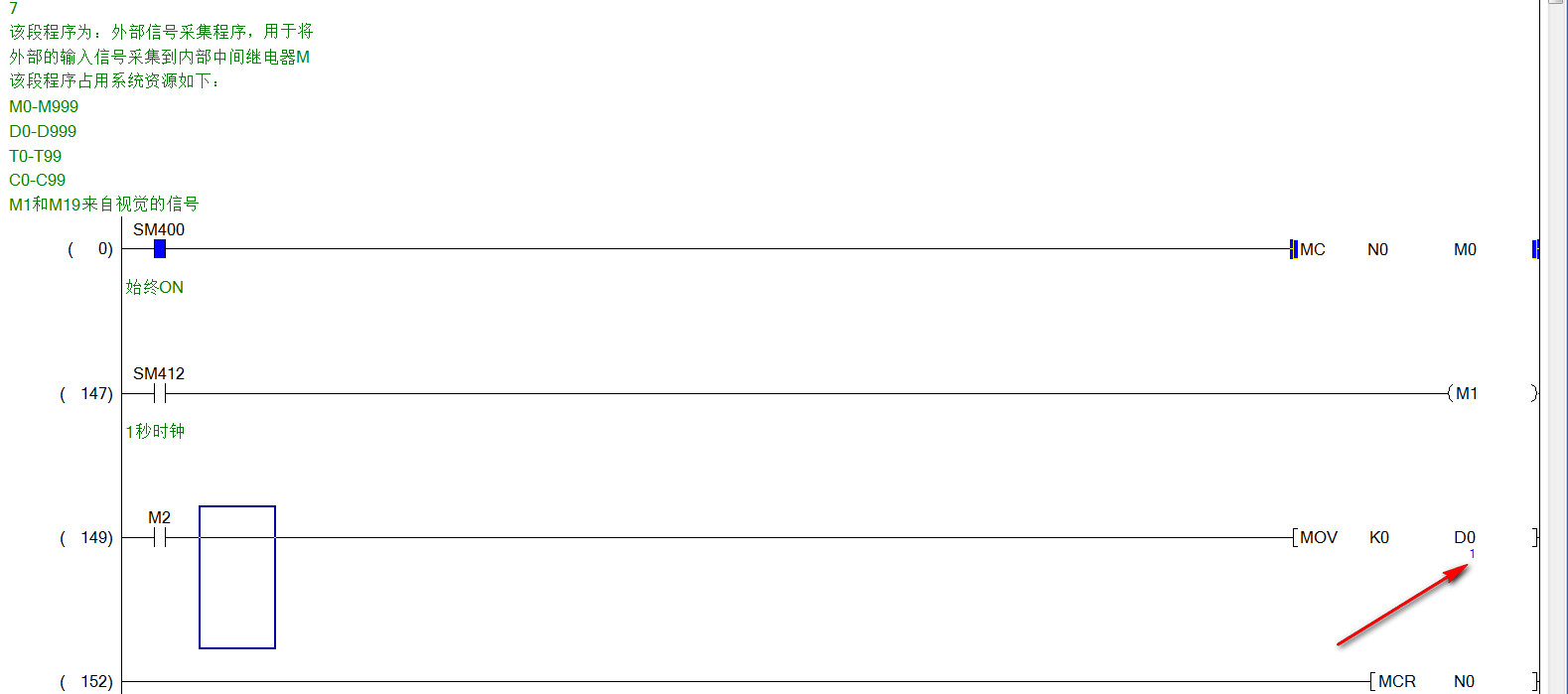

    测试随机写入
        Private Sub btn_WriteDeviceRandom2_Click(sender As Object, e As EventArgs) Handles btn_WriteDeviceRandom2.Click
            ClearDisplay()
            'Join each line(StringType array) of 'DeviceName' by the separator '\n',
            'and create a joined string data.
            'Check the 'DeviceSize'.(If succeeded, the value is gotten.)
                Exit Sub
            End If
            'Check the 'DeviceValue'.(If succeeded, the value is gotten.)
            If GetShortArray(txt_DeviceDataRandom, sharrDeviceValue) = False Then
                Exit Sub
            End If
            Try
                iReturnCode = AxActUtlType1.WriteDeviceRandom2(szDeviceName, iNumberOfDeviceName, sharrDeviceValue(0))
            Catch exception As Exception
                MessageBox.Show(exception.Message, Text, MessageBoxButtons.OK, MessageBoxIcon.Error)
                Exit Sub
            End Try
        End Sub
    #End Region

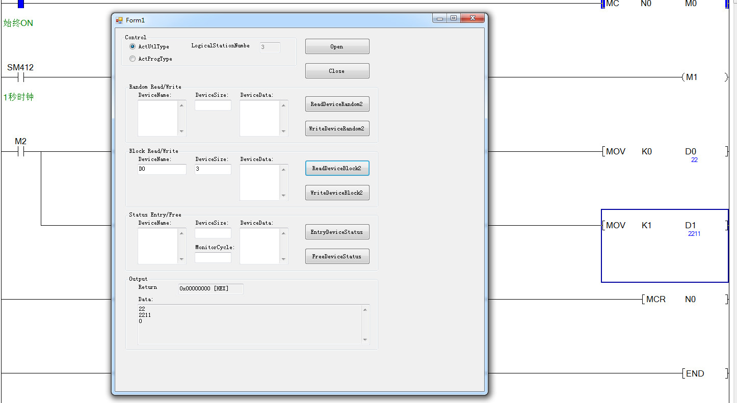

    测试成块的数据读取
    #Region "测试成块的数据读取"
        Private Sub btn_ReadDeviceBlock2_Click(sender As Object, e As EventArgs) Handles btn_ReadDeviceBlock2.Click
            ClearDisplay()
            szDeviceName = String.Join(vbLf, txt_DeviceNameBlock.Lines)
            If GetIntValue(txt_DeviceSizeBlock, iNumberOfDeviceName) = False Then
                Exit Sub
            End If
            'Assign the array for 'DeviceValue'.
            Try
                iReturnCode = AxActUtlType1.ReadDeviceBlock2(szDeviceName, iNumberOfDeviceName, sharrDeviceValue(0))
                Exit Sub
            End Try
                'Assign array for the read data.
                Next iNumber
            End If
        End Sub
    #End Region
