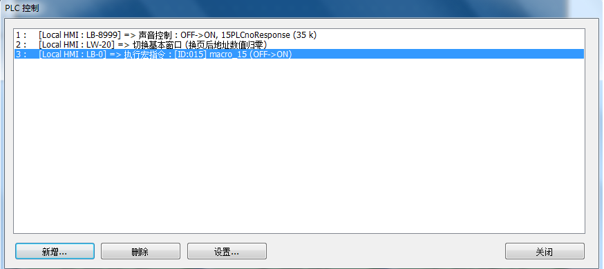

    用宏来做:
    macro_command main()
    int Pass,DataEn=0
    short Page
    bool  ON=true,Off=false
    GetData(Pass, "Local HMI", LW, 2, 1)
    if pass==123456 then
       page=10
       SetData(page, "Local HMI", LW, 20, 1)
    else
      SetData(ON, "Local HMI", LB, 1, 1)
      end if
      SetData(Off, "Local HMI", LB, 0, 1)
      SetData(DataEn, "Local HMI", LW, 2, 1)
    end macro_command
