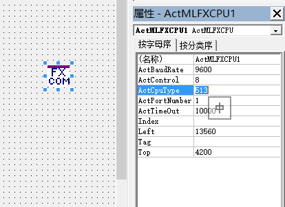

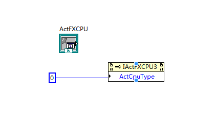

MC控件里的 ACTCPUTYPE对应的是FX PLC的型号  那么对应的参数是多少  2N是数值是多少 3SA数值是多少   3G的数值是多少  3U的数值是多少 问三菱的客服 居然说不对外开放 谁给个三菱整个系列PLC对应的数值的表啊

2楼  发表于: 2017-08-10 15:52

    ''' FXCPU
    Public Const CPU_FX0CPU As Short = &H201S ' FX0/FX0S
    Public Const CPU_FX0NCPU As Short = &H202S ' FX0N
    Public Const CPU_FX1CPU As Short = &H203S ' FX1
    Public Const CPU_FX2CPU As Short = &H204S ' FX2/FX2C
    Public Const CPU_FX2NCPU As Short = &H205S ' FX2N/FX2NC
    Public Const CPU_FX1SCPU As Short = &H206S ' FX1S
    Public Const CPU_FX1NCPU As Short = &H207S ' FX1N/FX1NC
    Public Const CPU_FX3UCCPU As Short = &H208S ' FX3U/FX3UC
    Public Const CPU_FX3GCPU As Short = &H209   ' FX3G/FX3GC
