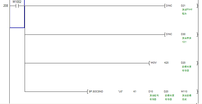

最近在做二台设备,之间需要资料互传,配置了Q10UDEH,使用交换机将两台CPU连接。要怎么样设置才可以实现W0~W1FF的资料互传。有没有大侠做过这一块的。

參考ZNRD跟ZNWR指令寫法就可以

我剛剛說的指令錯了那是網路模組的
自帶網路功能的要寫
SP.SOCOPEN Establishes a connection
SP.SOCCLOSE Disconnects a connection
SP.SOCRCV Reads out received data (in END processing)
S.SOCRCVS Reads out received data (upon execution)
SP.SOCSND Sends data
SP.SOCCINF Reads out connection information
SP.SOCCSET Changes communication target of UDP/IP communication
SP.SOCRMODE Changes receive mode of the connection
S(P).SOCRDATA Reads out data in the Socket communication receive data area
http://blog.xuite.net/fa.system/twblog

7楼  发表于: 2014-05-20 09:16
像这样

    UDEH自带网口的不支持网络模组指令
