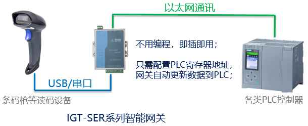

发表于: 2021-12-09 09:41
相关案例:
https://blog.csdn.net/AutoCtrl666/article/details/121099627
