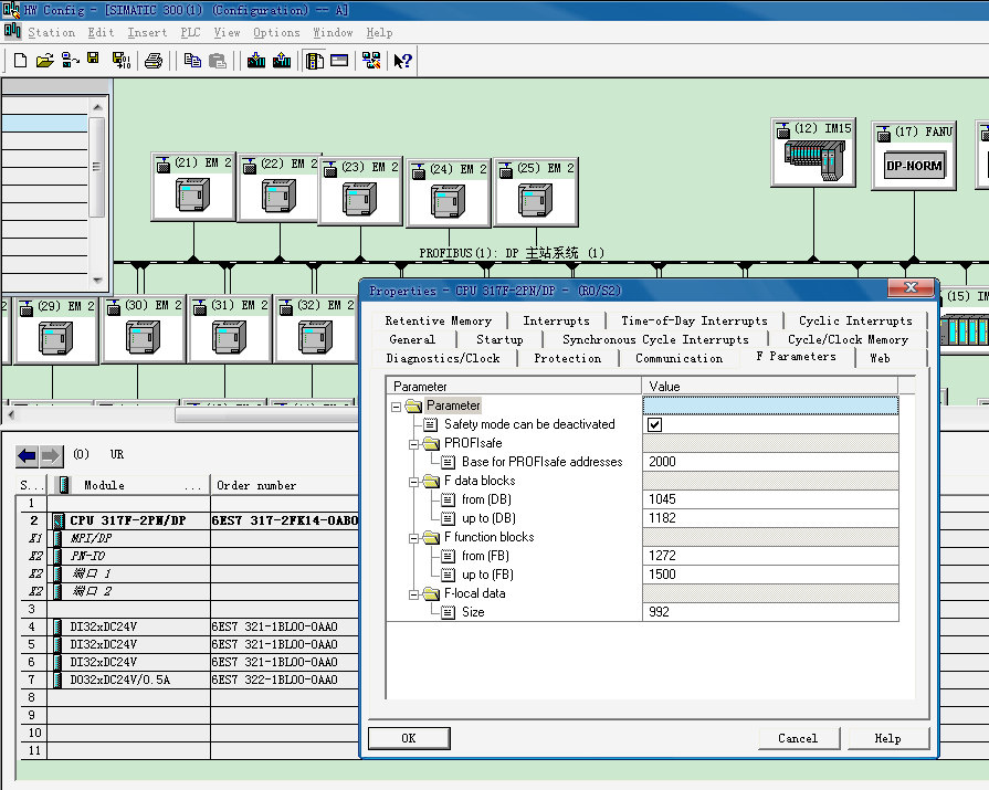

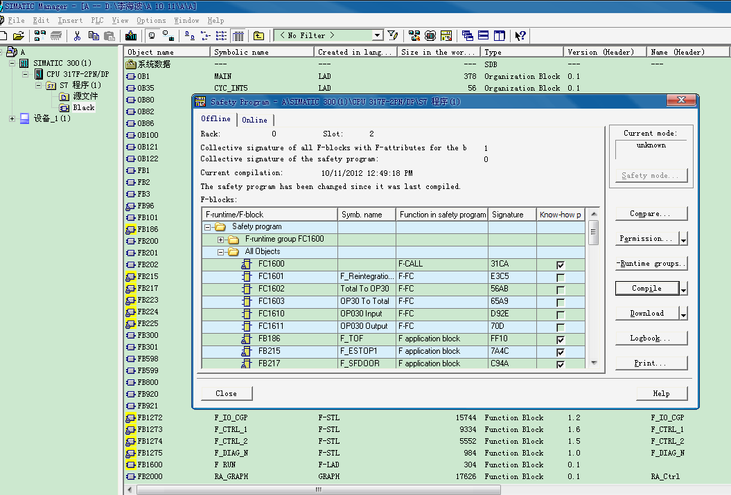

本人菜鸟  在编译Safety  Pragram 的时候 出现下列报错, 求大神教下我哪里出了问题了
以下是他的报错信息:
Cannot compile due to inconsistencies
between the F-shared DB and the hardware
configuration. Compile the hardware
configuration again with the "CPU contains
safety program" option set.
The compilation of the safety program was
aborted with 1 errors and 0 Warnings.

硬件配置错误
