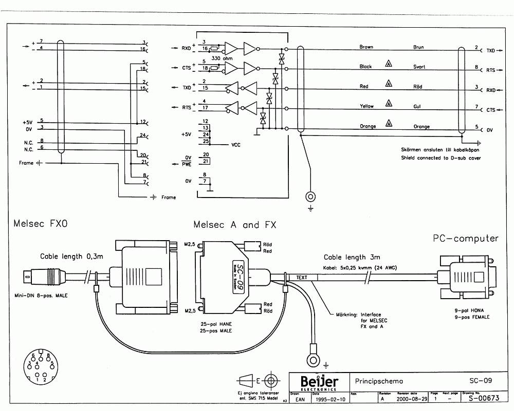

MITSUBISHI CABLE
ngocvinh056
4 个
122 点
783 分
在线时间: 18(小时)
2012-01-24
2013-12-15
查看ngocvinh056的
发表于: 2012-08-03 00:32
WHAT IS THE TYPE IC IN THE CIRCUIT ? I DONT KNOW IT

This cable can be purchased easily, and so cheap that less than 30rmb cost. Maybe it is cheaper than make by yourself.

haizz, I WANT TO HOME MADE. IS THIS MAX488 AND 74HC04. AT HERE,IT IS VERY CHEAP THAN HOME MADE

SORRY,IT EXPENSIVE
