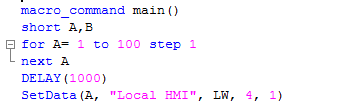

macro_command main()
short A,B
for A= 1 to 100 step 1
next A
DELAY(1000)
SetData(A, "Local HMI", LW, 4, 1)
end macro_command
为什么LW4不能显示从0到100啊
