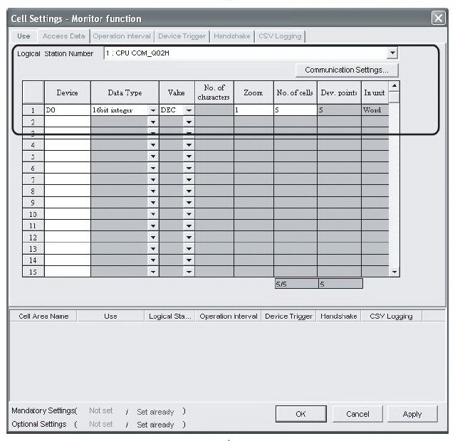

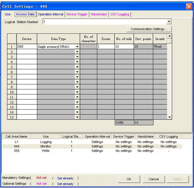

请教各位,为什么我的MX SHEET的Access Data里面没有Value一栏,使用起来“Monitor”和“Logging”功能正常,“Write”却始终无法实现,错误记录为:
“The wrong value is inputted into the cell area.
Write process of the corresponding cell area was not performed.
The corrective action is as follows:
Input the data in the entire write cell area.
Set either 0/1 data in the bit type cell.
Confirming whether the string data is not set in the cells other than string type.
Magnification is set up so that operation result may not overflow.”
请用过的大大指教。
说明书上图片
我实际运行后截图

When "Data Type" has been set to "Bit" or "Character string", the
"Zoom" setting is not possible.
