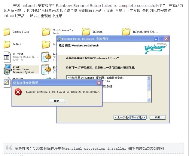

intouch【Rainbow Sentinel Setup failed to complete successfully?
